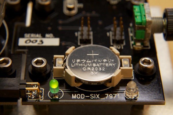

Carl Ott designed the boards as well as the firmware for this clock.  He did a great job designing it to be modular; the clock comes in 5 pieces, 1 power supply, 1 CPU, 3 display boards (each one holding 2 tubes).
The PCB itself is a nice black board with the substantial portion of the components being surface-mount.  In fact, lost of the circuitry is hidden on the underside of the board which gives the device a nice clean look.
The power is supplied by a Taylor Electronics  45mA, 180V DC 1264 HVPS-H design.  It is pretty cool; the device is about the size of a large postage stamp and it provide more than enough power to run the 6x B7971’s.
The CPU is an ATMEGA 168-20AU and there is a programming connector on the top of the CPU board.  As new versions of the firmware are released, you will be able to use this interface to update the (already great) software.
The time is kept using a MAXIM RTC DS3232.  It is a temperature controlled oscillator with an integrated real time clock.  This device features an accuracy of +/- 2ppm in normal operating temperature ranges (or about 2 x 10^-6 accuracy).
Light Sensor
The clock allows you to set two brightness levels, appropriately named DIM and BRIGHT.  Each value is set independently (0-255) and the clock can automatically switch between these based on the ambient light in the room.
On the CPU board, to the right of the battery is what looks like a clear LED.  This is a photo sensor that the clock uses to gauge the ambient light in the room.  You can read the value of this via the menu (0-255) and use it to determine at what point you want the display to go dim or bright.
Once you have a level set that you like (mine is 200), you can set the threshold in the software.  So, when the ambient brightness is at 200 or higher, it switches my tubes to BRIGHT.  When it is less than 200, it sets them to DIM.
In addition to being a cool feature, this helps you prolong the life of the tubes.  By keeping the displays dim, you can prolong the life of these already hard-to-find tubes.

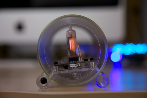

The Enclosure
The stand out feature, in my opinion, is the enclosure for this clock.  I’ve reviewed clocks made from wood, from Plexiglas, from acrylic, and from metal but never one from glass.  I’m not an artist but it seems like glass would be a particularly difficult material to manage and that is exactly why this clock is so cool.
The glass is brand called Simax and is made in the Czech Republic.  Is it a borosilicate glass (similar to Pyrex) that is exceptionally clear and sturdy.  The construction of the enclosure is pretty unusual.  The glass is shipped in a tube shape but you cannot simply take a hack saw and cut it to length.
The main body is to a 150cm length and then smoothed out with a torch.  To relieve the stress created by heating the ends, the entire tube is placed in a kiln for several days in order to relieve internal stresses created.
The glass fee take even more work. Miachel had to cut this with a water-cooled glass saw and then grind down the edges using a special wet belt grinder using various grits.  This gives the feet a smooth edge that looks very clear.  The feet are adhered to the main tube using industrial glass glue.
The internal components are suspended in the tube using a piece of acrylic.  It is capped off using two circular pieces, one with the ColdWarCreations logo and one with the CCCP mark.
The net effect: this enclosure is awesome.
