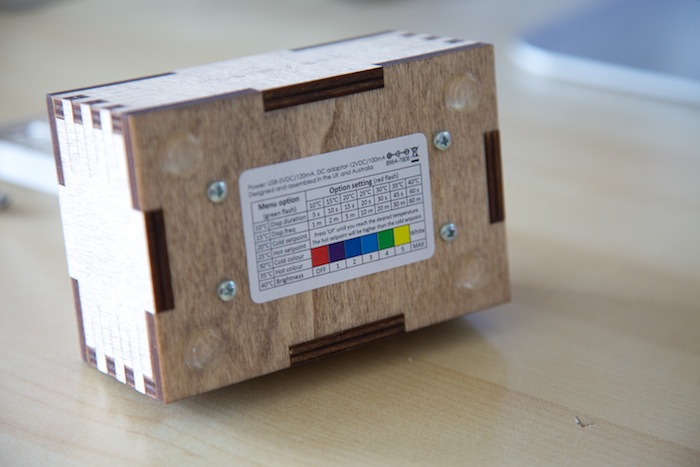

The scale itself deserves some attention too. At 1 CM, it is considerable thicker than the neon tube. The tube sits in a channel that has been drilled out of the center so it provides stability across the entire length of the tube. The channel is just deep enough to protect the tube but not distort the display in any way. The tube is still exposed on the front and back but it is well protected.
The base of the device made out of what appears to be laser cut wood. The panels are 5MM thick and fit solidly together. The photos give a pretty good idea of how the case is actually built. On the front of the device the thermNeon logo is etched. On the back are cutouts for the power, the sensor, and the buttons. On the bottom is a sticker with an abridged version of the menu.

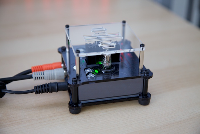

This little device comes to us from NixieKits.eu. It is a dual triode headphone amplifier from based on surplus Russian military tubes. This is a largely subjective review but I’ll do my best to stay as factual as possible.
Video Review:
Each new gadget from NixieKits.eu has a more refined enclosure than the previous and this is no exception. The device is made out of (what appears to be) laser cut acrylic and has a very solid feel. The panels are slotted and fit together nicely and give the entire device a solid feel.

To begin, I left this device disconnected and plugged in my headphones. I let it warm up and turned it up all of the way. The result: silence. This is fantastic. Not even my home stereo amplifier has complete silence when I turn it up all of the way.
To test distortion, I played a techno song with a deep and loud baseline. I compared how it sounded coming directly from my computer versus from the amplifier and the difference was notable. The song was clearer at louder volumes using the amplifier than it was without. I played with a few other demo songs that Jürgen sent me and the results were similar.
On the quiet end, it doesn’t add any noise. On the loud end, it doesn’t distort or clip the waveform like a transistor-based amplifier does.
As far as the “warm” sound of a tube amplifier it is there. If, like me, you only grew up using more modern designs, it may sound foreign at first. It is not very pronounced but if you know that it is there, you can hear it. For things like an acoustic guitar, I really like the results. For piano solos, things sound a little muted but not in any bad. This is completely subjective and depends on your preferences. I can say, however, that since I received this device, I have not disconnected it from my system!
