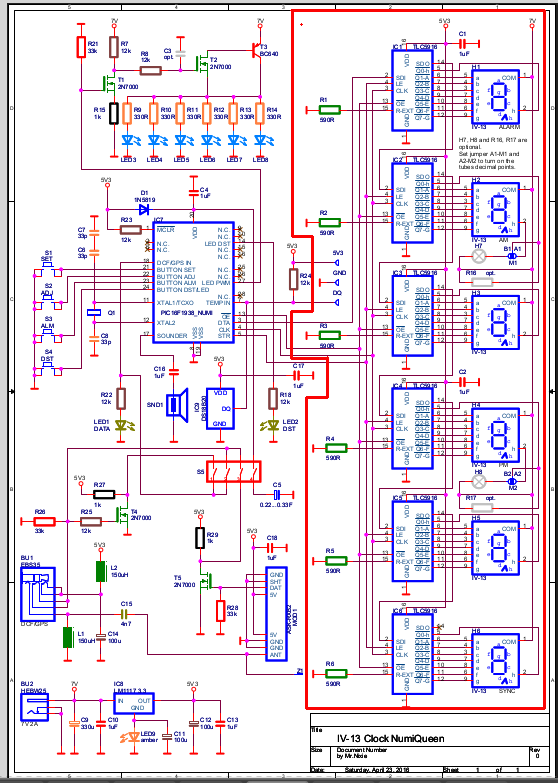

The schematic for the NumiQueen is not particularly large or complicated, and it breaks down into the following parts:
The power supply
The controller circuit, buttons and speaker
The LED driver
The tube drivers
The tubes
The case
We'll tackle each of these in turn.

The power supply is a fairly normal linear LDO (Low Drop Out) regulator based on the LM1117. Interestingly, the regulator uses a 3.3V regulator, along with an LED to "push" the ground of the regulator up to around +2V, this gives an effective regulated output voltage of 5.3V.
The power supply is made up of IC8, BU2, C9, C10, LED9, C11, C12 and C13. the capacitor C9 is mounted on the board in a cut out to reduce the profile of the board.
Putting these on the board only takes a few minutes, and powering the unit up gave us a nice amber light. The voltages measure within range, so we are good, A tip when installing IC8 is to put a small blob of solder on one of the pins, then align the chip with just this one pin soldered. When it is aligned how you want, solder the other connections.

Next up is the controller, plus the supporting components so we are able to see and/or hear that the controller is working. This circuit gives us the oscillator for the controller plus the switches and the speaker, as well as a resistor to enable the controller and some decoupling. With these components, I hope to hear the controller peep when I press buttons, which will prove that the controller is alive. The components we are installing here are IC7, S1-4, Q1, C6-8, R22-24, C4, C16, D1, LED1 and SND1.
Put the socket for IC7 on the board with just one or two pins, then solder the rest when it is aligned how you want.
After putting these components on the board, we hear beeping from the speaker, so we are good.

I wanted to build the whole LED circuit in one go, but I was not sure exactly how the LEDs should be mounted. The manual was not very clear about this. I noticed that the holes on the board were large enough that the LEDs passed through them without trouble. Also the sockets seemed to have a hole in the center with just the right size for the LED head to fit in it. I made the guess that it would be best to fit the LEDs later. I did the rest of the circuitry, but did not mount the LEDs just yet.
The LED driver is made up of some control circuitry to allow the LEDs to be switched on and off (T1-3, R7, R8, R15, R21), current limiting resistors (R9.14) and the LEDs themselves (LED3.8).
I wasn't able to test this yet, so moved on.

All of the clever stuff for the tube driver circuit goes on in IC1-6, meaning that the circuitry for the tube driver circuit is deceptively simple. The only slightly tricky part of this part of the build is mounting the tube sockets, which are really easy to get skewed. I started by soldering one pin of each socket, and checking that they were seated properly. Once they looked good, I soldered the opposite pin of each socket and checked the alignment again. Once I was happy, I soldered all the remaining pins.
I fired up the clock with just one tube installed, and it worked great!
After this, I installed the other tubes and checked that they worked! Yaaay!
