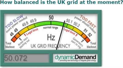

First of all, the time source comes from the frequency of the mains supply voltage, which is a surprisingly good source of time: supply companies in all but the most dark and backward countries in the world actively manage the number of cycles delivered to the consumer very tightly, even regulated by law in some countries. For example, the supply in the UK can be seen here: http://www.dynamicdemand.co.uk/grid.htm, and on the dial you can see markers for the "Legal Limit" of deviation, over which the supplier is subject to sanctions.
![UKGridFrequency](/just-photos/image?view=image&format=raw&id=281&type=img)
This is the momentary frequency, which varies all the time, according to load and generating factors. For example, when people wake up, demand increases, and to meet the extra demands, the suppliers crynk up their machinery to deliver more current, but this also has the effect of increasing the frequency momentarily. To compensate for this, the suppliers manage the frequency over the long term as well, often scheduling a small increase or decrease in frequency over the coming days, gauranteeing over a period of days that the frequency will hit exactly the target frequency.
