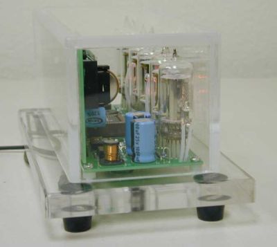

By Jeff Thomas / Resonant Instruments, LLC
Price: $299 / eBay
Jeff Thomas GPS Clock
Jeff Thomas has another great nixie clock for sale on eBay.  It is a $299 GPS 6-digit nixie clock that is encased in a clear arcrylic enclosure.  I have a Nixichron by him and it is easily one of the best designed clocks I own.  After reading the manual, this clock appears to have the same or a very similar setup.  The GPS feature is a very nice touch.  If you have ever had a power outage you will appreciate not having to reset this device.
