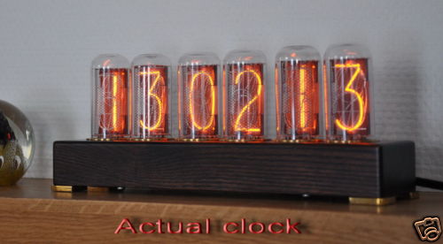

Tube Hobbie Nixie Clock
Tube Hobby has a handsome, fully assembled IN-18 clock with a wooden base for sale on eBay.  The current price is just under $300 with 4 days left on the auction.  Below are the specs provided in the auction but please visit the ebay link below to learn more.  They have provided links to the data sheets and the user manual at the bottom of the auction.
