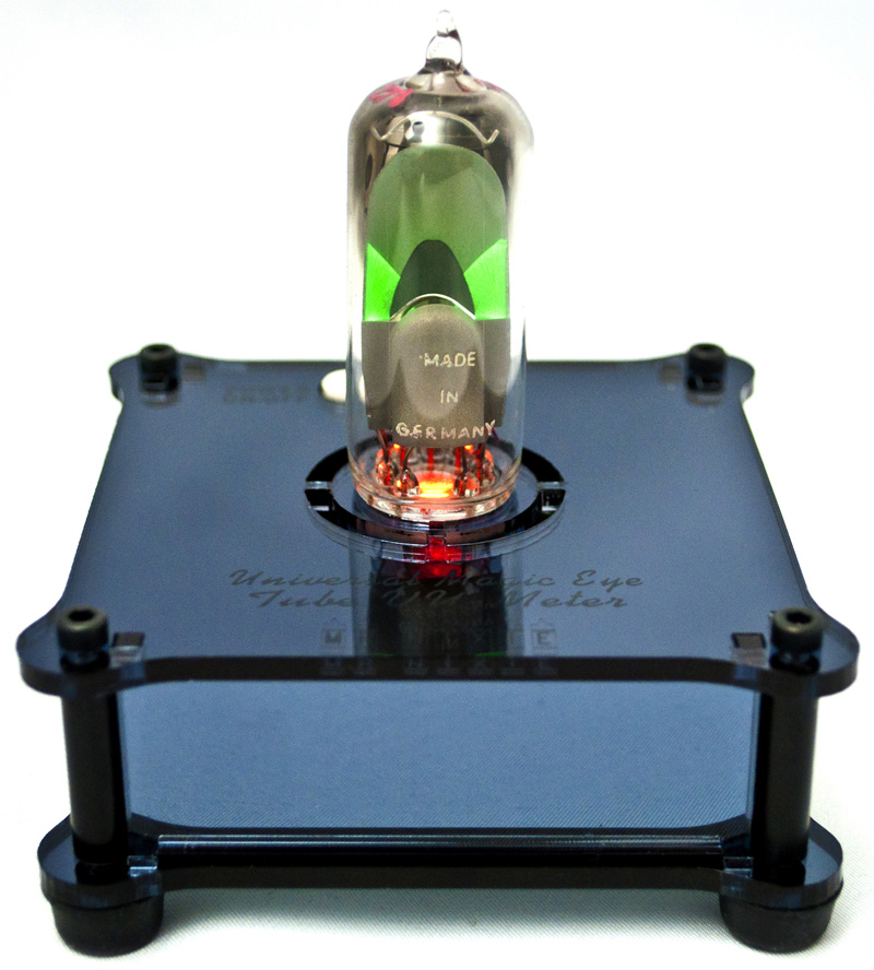

No much words, just look at the very first prototype.

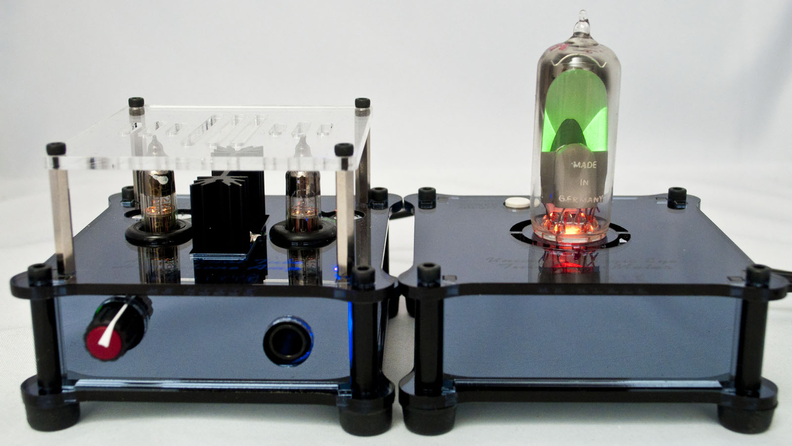

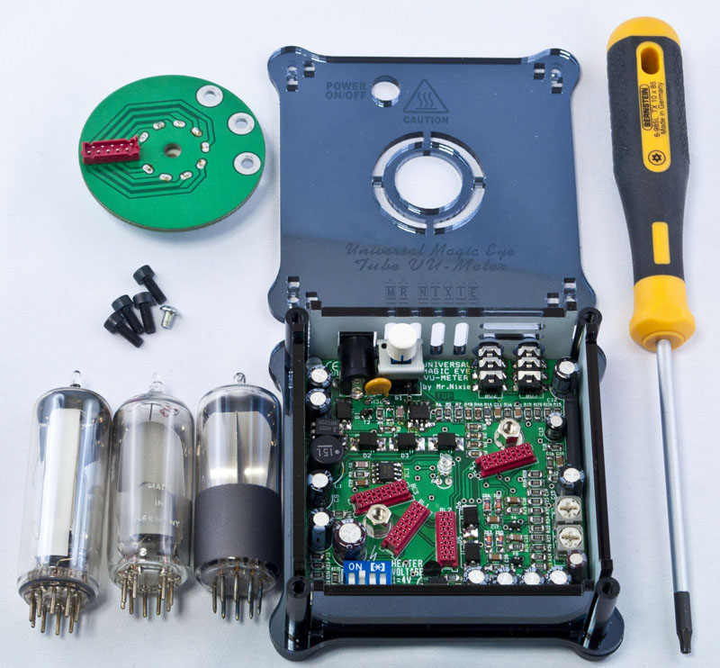

The PCB is made with a lot of SMT parts, all these will be pre-assembled by the PCB manufacturer, so you only need to fit the "big sized" parts. Therefore assembling within one hour is not a problem at all.
The case has the same size and style as my headphone amplifier, so they become the really "Dreamteam"

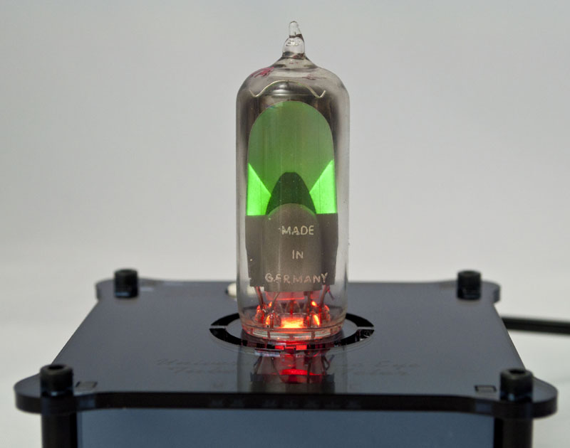

Here are some pictures with different tubes:
The well know Russian 6E1P

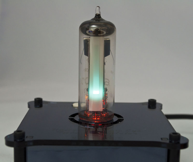

TELEFUNKEN EM800 "Thermometer" Magic Eye

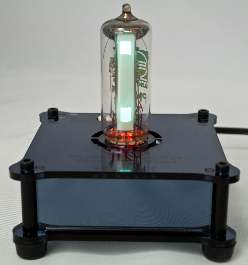

A PM84 (4FG6) with 4V heater voltage

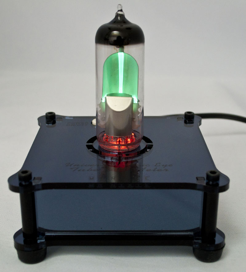

Really stunning and rare: LORENZ HM85 with 12V heater voltage (12DH7) (this is the side view version of the "breathing" EM71 from Michael Barile

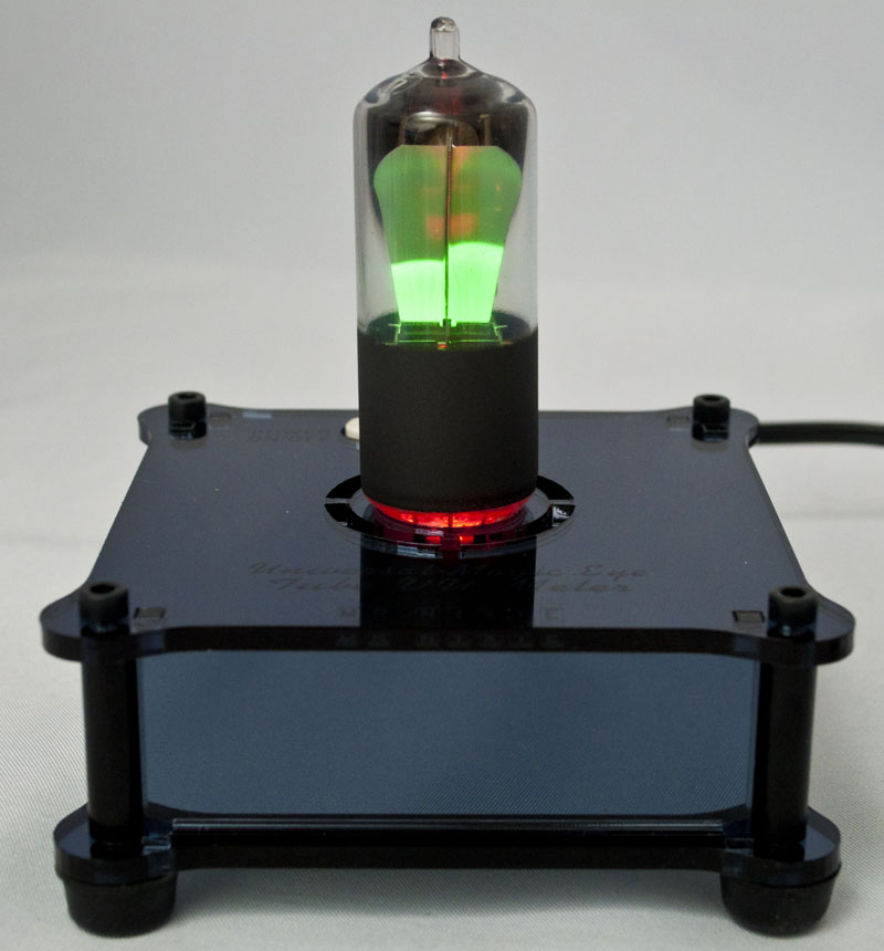

And last but not least a true stereo tube: The Funkhaus EM83
As the electronic is made in full stereo you'll get with this tube a left / right channel display

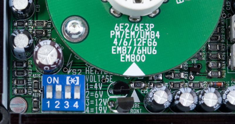

Easy selection of the heater voltages with a DIP switch
And if you do a mismatch, let's say inserting a 6V tube and the power supply is set to 19V?
A polyfuse (self resettable fuse) will be triggered, so your tube is safe and the heater will not burn.

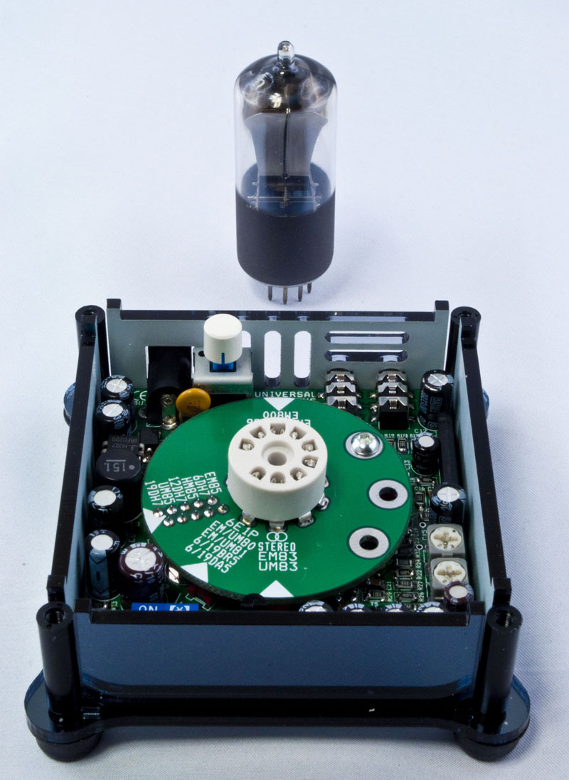

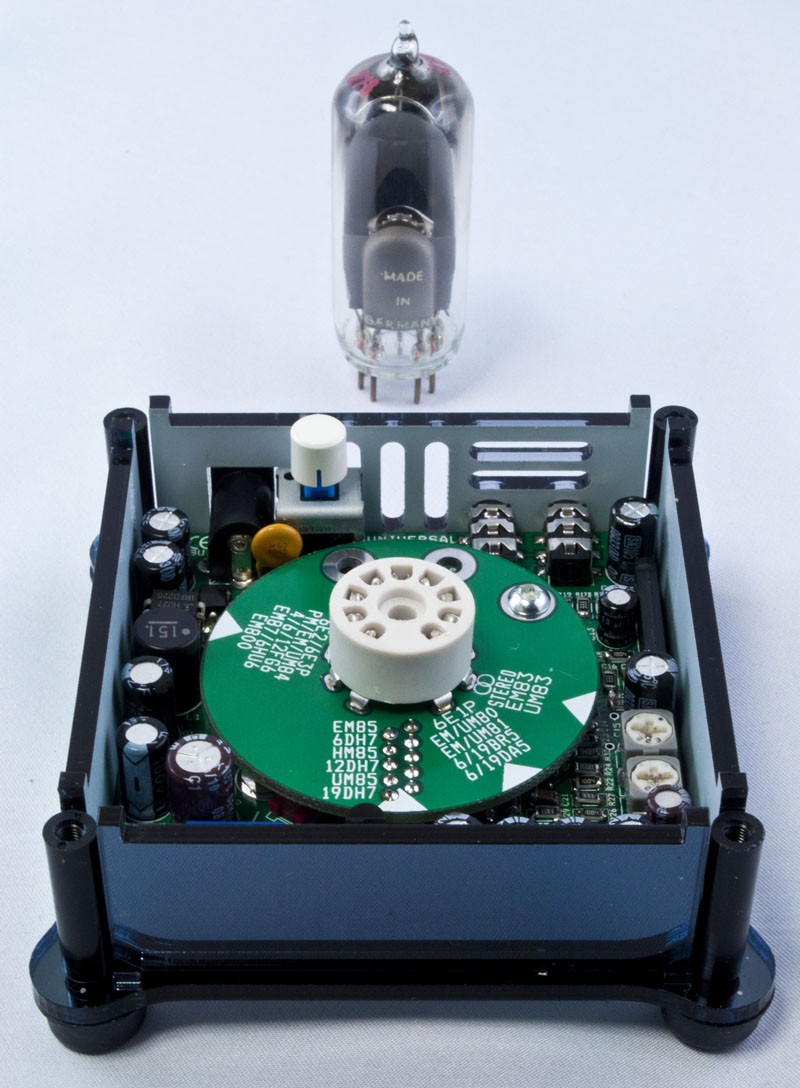

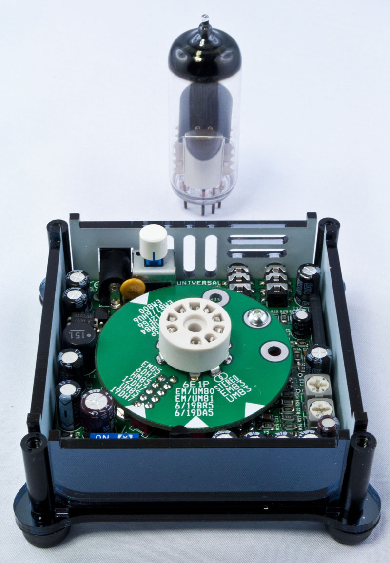

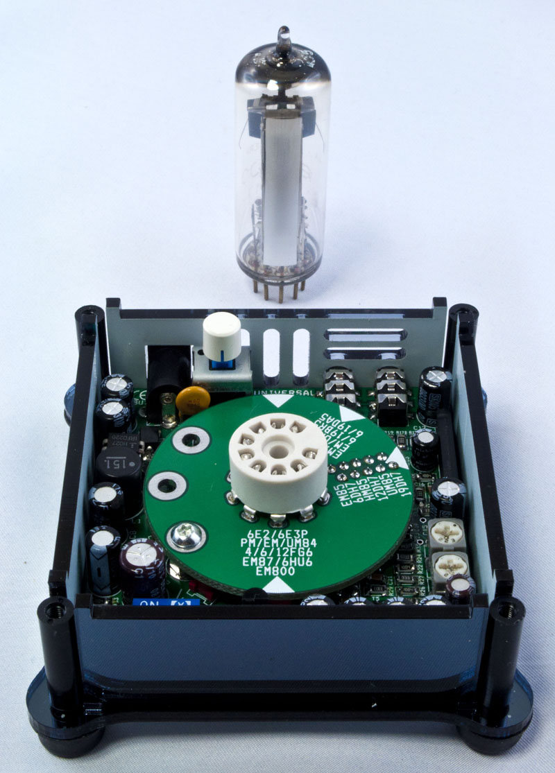

And how can so many tubes be inserted without the need to solder adapter wires?
Have a look at the pictures below. You may understand the "trick". Look at the board socket direction and on the tube's pin direction
And as I told: No soldering required when changing the tube's type...

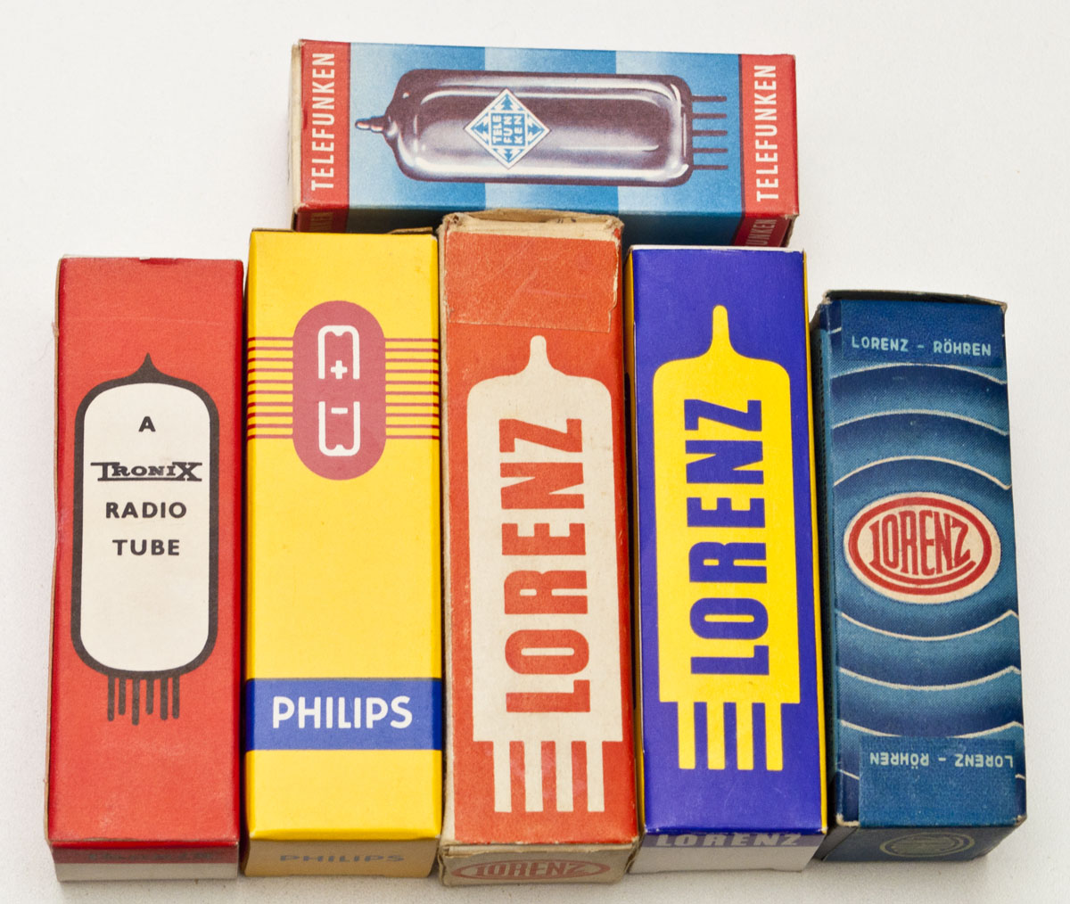

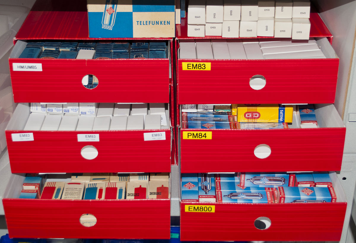

And have you seen on my website www.Nixiekits.eu I can now offer a bigger batch of NOS / NIB Magic Eye tubes?
And here are the boxes from my NIB Magic Eye tubes
